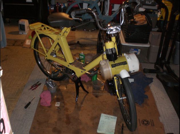

Here is a customer's yellow 1974 Velosolex 4600 V1 that I will be reconditioning in the coming weeks:
1974 Velosolex 4600 V1 CLeo-s-yellow-1974-4600-V11198
As you can see, the headlight, tailight and toolbox are missing. The paint is peeling off of the frame, and some parts are rusty. The engine will need to be rebuilt.

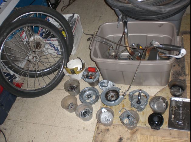

I have:
-totally disassembled the bike and engine.
-sent the frame pieces to the painter
-cleaned and decarbonized the engine pieces
-replaced the crankcase bearing (6203 2RS C3) and the seal
-Flex-honed the cylinder and painted it with high-temperature paint
-cleaned the points, tested the ignition coil and condenser, and made a new spark plug wire assembly.
-cut the decompression valve seat using the special valve seat tool
-resealed the front of the fuel pump
1974 Velosolex 4600 V1 CLeo-s-yellow-1974-4600-V11247

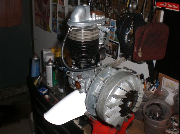

I am rebuilding the engine...I have:
-painted the small front fender white
-installed a new plastic dust protective plate
-adjusted the points (timing)
-installed a new fuel pump seat and diaphragm
-installed a new stator bearing, 6202 2RS C3
-installed a new spark plug wire
-cleaned and gapped the spark plug
1974 Velosolex 4600 V1 CLeo-s-yellow-1974-4600-V11248

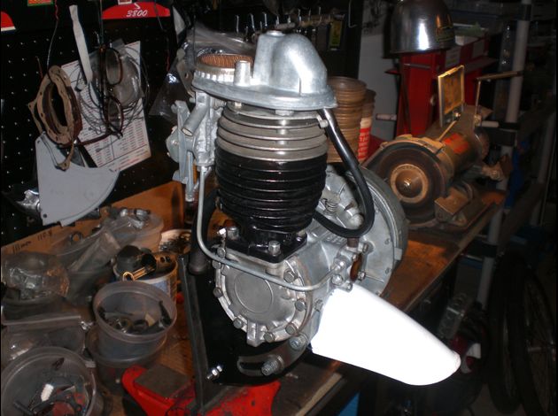

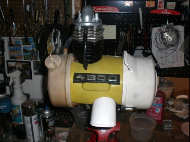

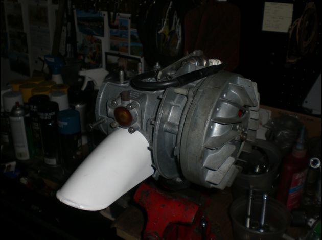

I have finished reconditioning the engine. More parts used:
-fuel tank filter
-small metal flywheel cover
-gasket for small flyhweel cover
-nut for small flywheel cover
-stator bearing, 6202 2RS C3
-fuel overflow tube
-gasket and seal set
-cleaned the carburetor and air filter
It is very important that the various engine nuts and bolts be tightened in the proper sequence,
and that they are torqued to the proper specifications.
Check the service manual posted on my Velosolex 4600 site for the proper sequence and torque.
Hopefully, the customer will request a new white fuel tank and new white flyhweel hood.
1974 Velosolex 4600 V1 CLeo-s-yellow-1974-4600-V11249

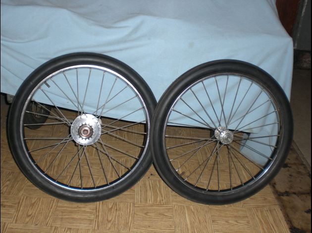

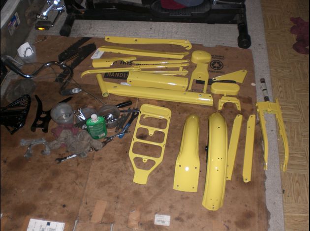

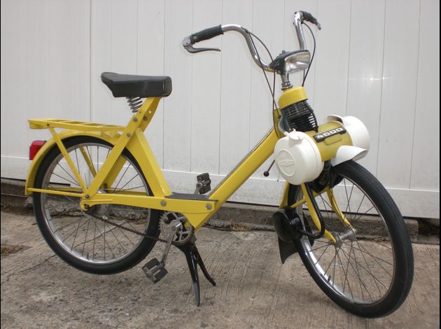

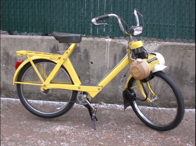

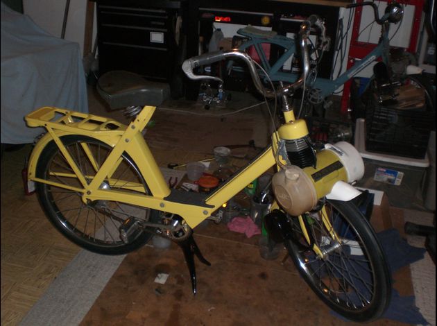

Inlägg  BrianSolex i mån dec 21, 2009 3:28 am
I have: polished the wheels; cleaned, greased and adjusted the bearings;
cleaned and lubricated the freewheel; installed new Michelin tires.
1974 Velosolex 4600 V1 CIMG1406
Also, the parts have returned from the painter.
And I have polished the handlebars and pedal-crank assembly.
1974 Velosolex 4600 V1 CIMG1409

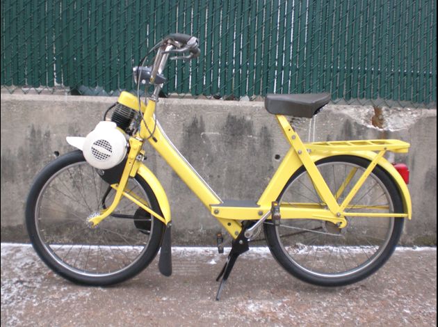

1974 Velosolex 4600 V1 Empty Sv: 1974 Velosolex 4600 V1

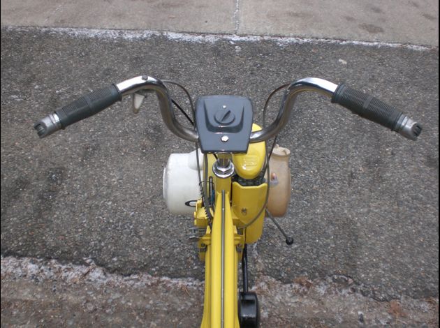

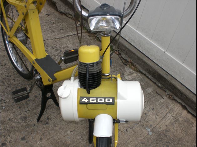

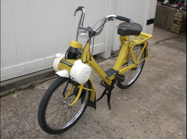

Inlägg  BrianSolex i sön jan 03, 2010 2:43 am
The Solex is all assembled.
I have installed a new headlight and taillight, a new sheath for the decompressor cable, a new rear brake cable,
new wiring, several new bolts and nuts, etc.
I have cleaned and painted the exhaust muffler.
The customer is going to polish the bike and install the stickers.
I will try to make a video and take some better photos tomorrow or later this week, depending on the weather and such.
1974 Velosolex 4600 V1 CIMG1415
Inlägg  BrianSolex i tis jan 05, 2010 6:15 am
The engine started on the first try and it runs very well.
Here is a video:
https://www.youtube.com/watch?v=SqcS9CUZfTs
1974 Velosolex 4600 V1 CIMG1419
1974 Velosolex 4600 V1 CIMG1417
1974 Velosolex 4600 V1 CIMG1418
Inlägg  BrianSolex i mån jan 18, 2010 12:47 am
I have installed a new white fuel tank and a new white flywheel hood...also, I have taken some new photos and a new video:
Photo Album
Video
1974 Velosolex 4600 V1 CIMG1431
1974 Velosolex 4600 V1 CIMG1430
1974 Velosolex 4600 V1 CIMG1432
The customer will pick up this Solex at the end of the month. He also owns another 4600 V1, and an S 3800.
